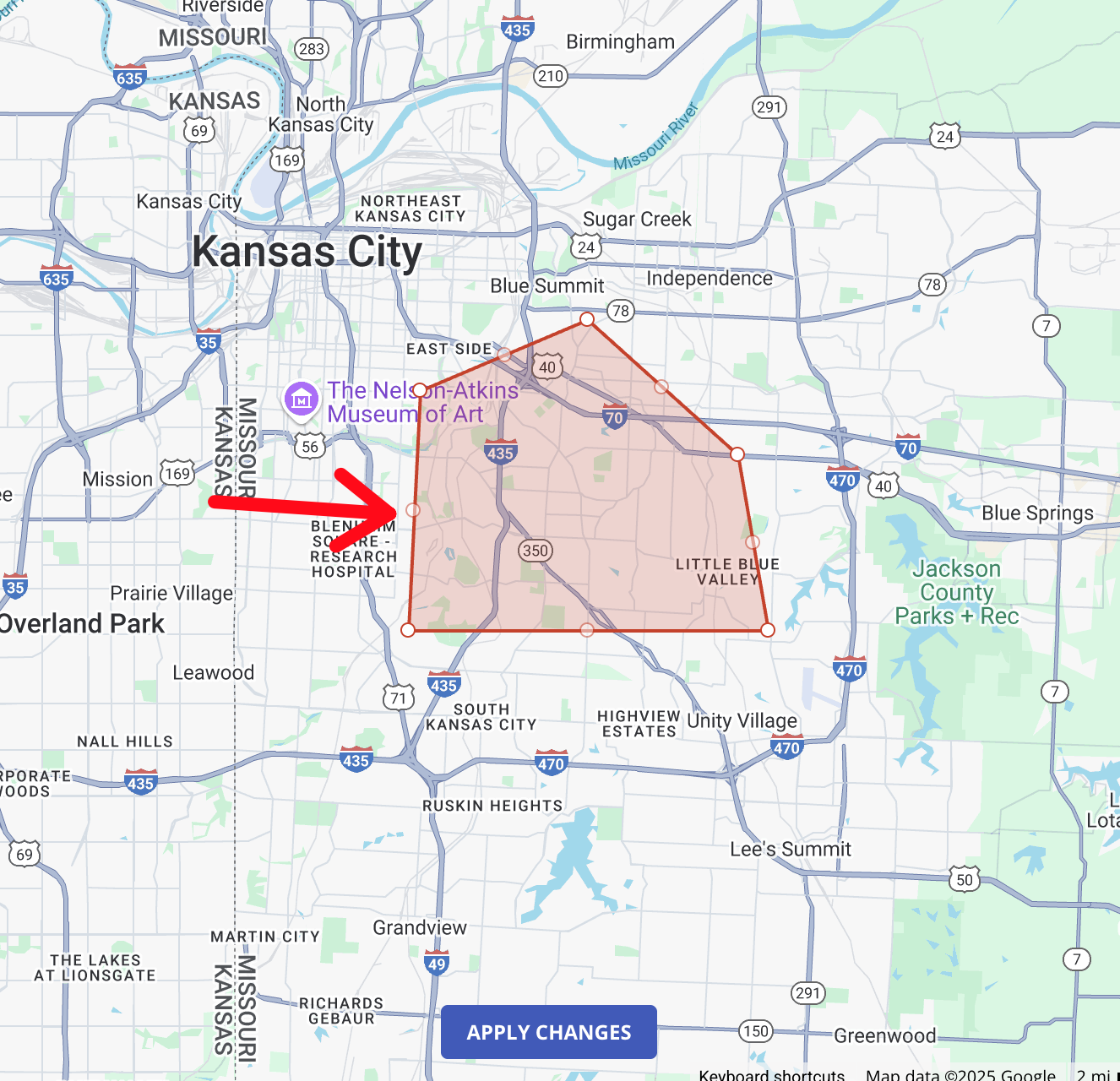

You can use the search bar to search for a specific city or address, or you can simply click on the map. Click the + Add button start defining the area you want to avoid.
A red square will now show on the screen of where the app will try to avoid. You can resize this square to be as large or as small as you like, click the polygon at the top of the screen if you would like to make an even more accurate area to avoid.
Use the border waypoints to adjust the size and shape to your liking.
Once complete, click Apply Changes at the bottom of the page to be directed back to the Routing Profile page. Lastly, hit Save at the bottom of the page to apply the changes to your profile.
